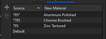

Below is a rough example of the type of Parts Material Template I am trying to make. Bear in mind it is only an example, but suffice to say that I have attempted more complex templates with far more rules that are not doing the job.
Are there any solutions to my problem? Am i using the system correctly? Does anyone else have any other solutions or workaround for this type of work? Is there a more in-depth functionality to wildcards and material templates that i am missing from the forums, manuals, and tutorials? Any help would be appreciated. I am using Keyshot 11.3.3 Pro, I can provide any other details as necessary.
